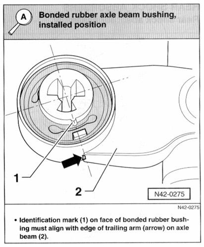

Your noise is likely a bad suspension bushing. Cheap to buy, a bit of a pain to change. I made this tool to change mine on my 2000 Jetta:
Here's the instal page from the manual:
Don't buy aftermarket bushings. The good, updated ones from the dealer.

I didn't drop the complete axle, I did the work on a hoist, and supported the beam with tall stands. It would have been an extreme pain without the tool I made. A ball joint tool is not big enough. C clamps weren't working. So, I went home, and made that tool. Back at the shop next morning, the bushings went in in five minutes.
My left bush was completely shot. Metal on metal, it made a horrible clunking noise. Car was silent, and handled much better after the work.
