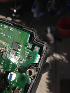

My daughters 2000 nb had the dreaded abs light for three years after I bought it used. After reading through various posts on fixing the faulty solder joints in the abs module, I pulled the abs module and opened it up. My abs module was slightly different from the one in most forums, but the issue was the same--namely, bad solder joints on the circuit board around two circuit board pins.
A local tv appliance store did the intricate soldering on two small pins on the circuit board for $25. Luckily for me, that solder fix turned off my abs light. The attached picture shows the cracked solder joints around the two large pins.
