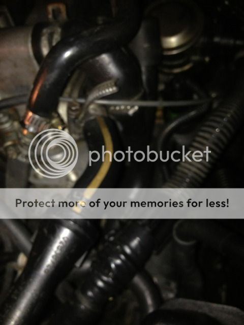

Please help me out here. I've just discovered a hose not connected to anything and am no sure where it goes. It's the one that comes from the Y thing which has a hose going down to the motor and the other one going straight which converts to a metal tube and later goes down from the back side of the motor around the turbo.
Please help me out here since this may be the leak I've been searching for
Well that looks like the vacuum T / Check valve for the brake booster.
It should be connected to the top of the intake manifold just to your left.

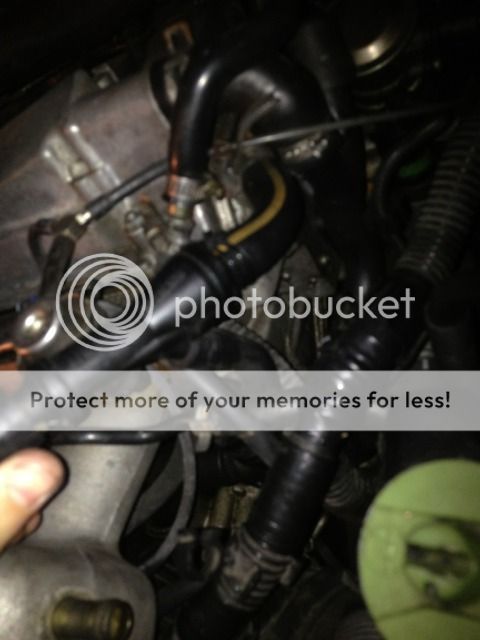

I also see an unconnected hose barb in the first picture of yours just below your thumb.
That one should have a hose connected to it running down to the PVC valve next to the block a little above and to the right of the oil filter housing.
Well thanks. I will check today. I went to start the car today and yesterday I did the wastegate mod. Once I started the car the car had ubstable idling. Very crazy idling. Once i step on it a little the come bak to idle was also very unstable. I touched the manifold and it was very very hot.
And it was the brake booster hose. I replaced them all with new silicone ones. They look pretty nice, still have a lot of cleaning to do in the engine bay tho.
