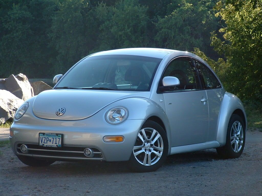

I love your Bug! The pics are awesome, I love the fence and field. I am a new owner of a Silver Arrow Beetle and since I am, I have been noticing more and more Silver bugs. AWESOME!

I love those summer pics :) Very gooood photography!
And the winter pics: at least now you have got enough of ground clearance! I like it too. I am planning to lift my Beetle also. But my goal is to lift it only appr. 2 inches.
