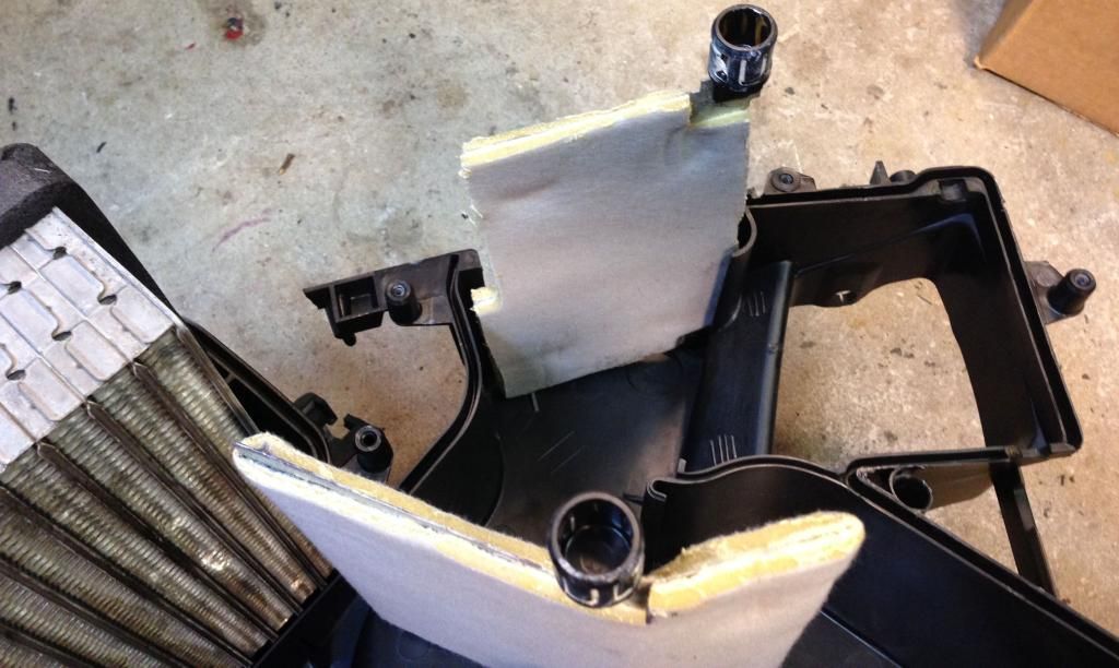

Thanks. I put Climatronic in my Jetta and I had to redo all the blend doors on it. I used headliner material, it worked great. I still have a bit left over. My plan is to do the swap in one day, so if I can save a bit of time it would be worth it. It took me several hours start to finish to cut and glue all 3 doors on the other box. I already have a new heater core, so I'll fit that at the same time.

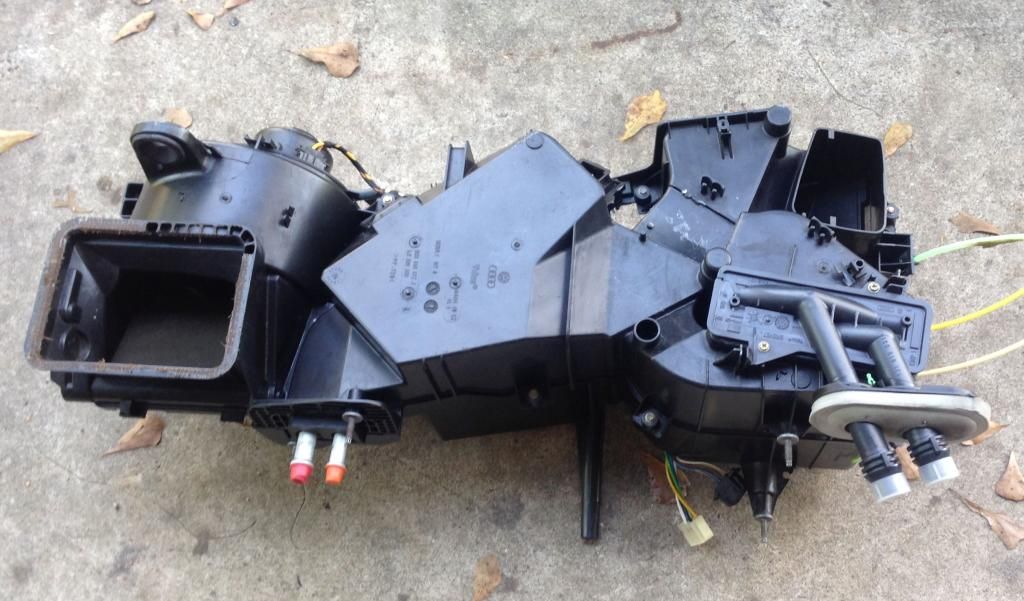

If anyone is wondering, the Jetta heater/evaporator box is the same. The cables were slightly different lengths (Beetle cables were longer) so I swapped them over. It's possible the Jetta cables would have worked, but I'm not sure.

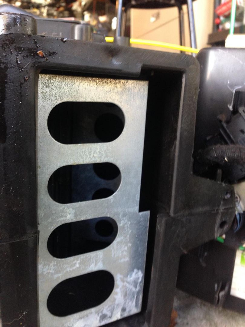

If you are wondering why the air doesn't go where it should, this is the reason. When the original foam deteriorates it is about as useful as the proverbial screen door on a submarine.
And here are the repaired doors. New headliner material glued to the metal door frames.
One repaired heater box ready to go in. I put in a new heater core as a precaution. I hope I don't have to do this again any time soon!
