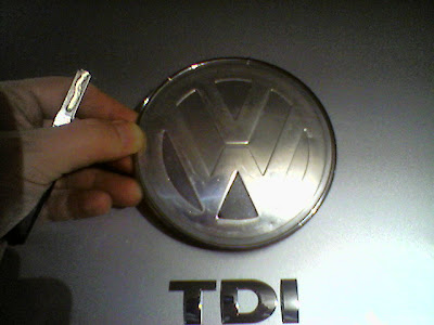

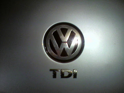

Hey All. Need to replace the totally faded hood and trunk emblems (flat badges, not the raised ones) on a 2002 TDI Beetle I just bought. The hood was cheap and relatively easy to replace ($32.00 from the local dealer + 30 minutes + hair dryer and scraping goo). However the trunk emblem, for some goofball reason costs like $93.00 and apparently is a bitch to remove. So instead of forking out the money right now around the holidays, I painted the emblem with waterproof black metal markers.
Before...
After...
Looks good until I get the real replacements. Plus i ripped off half of my thumb doing the front emblem and need to wait for it to heal ;)

both the front and rear emblems (i have the exact same ones) are put on the same way if you DO NOT have a swivel trunk badge. If your trunk badge never moves, you must use the botton to open the trunk and that's what i have. If it swivels and you can insert a key, that's the one that's a bitch to remove and why it costs so much.
Honestly, no matter which version you have the rear is always expensive. If you have the NON-swivel type, it's installed exactly like the front but without the plastic tabs to line it up properly. Either way, if it's non-swivel, you can use the old fishing line method to take it off.

Hobby Lobby. Over in the scrapbook section. They have big fat acrylic markers but these were more like a sharpie. Worked great and it poured here last night and it didn't fade or run.

Sweet. Then I dont have to remove the inside of the rear door! Thats awesome...still doesnt explain why the rear ones are so much more expensive (3x). Even the dealer parts guy was perplexed on that one.
Thanks for the info as all the howto's I found were for the 3d ones.
