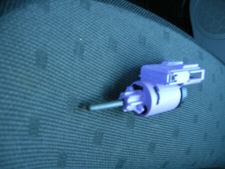

If it stays on, you need a new switch... proceed to the stealership and pay ~$14 for this...
Mine was big gay purple... In order for VW to keep track of what version a crappy electrical component is, they change the color... see my temp sensor thread for another example.
The original/recall 04 is black...

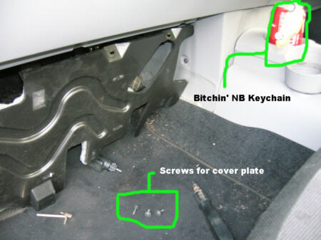

2) Remove the cover panel above the driver's side foot well...
3) Locate old switch, push in brake pedal, and twist switch body to remove...
4) Unplug 4 pin connector from old switch and plug into new switch (it only goes one way...don't force it!) Insert new switch into frame and depress brake petal. You should turn it until it locks into place and is positioned like the original.

I took this damn switch out and took it apart. The design is a total piece of crap. The whole thing relies on a spring to force a plunger out when the pedal is depressed which slides a set of "shoes" off a set of "cams" on the contacts and allows them to close the circuit (thus let electricity pass) and illuminate the brake lamps.
This makes the switch a "fail open" device (when either the spring doesn't generate enough force to move the plunger or the plunger sticks, etc.) which is an extremely unsafe condition, in that the tail-lights will fail to illuminate.:mad:
I'm posting detail pictures on the guts of the switch of what I am describing:
Brake Lamp Switch Assembly {Purple = VW's Second Design Attempt Version}:
Disassembled Switch (There was evidence of arcing inside the purple housing and around the outside contacts, see pic 1210 below)
Switch Contacts/Black Plastic "Cams"
Switch Spring Loaded Plunger w/ "Shoe" (lubricant on shoe)
Signs of Arcing Visible
Rotation sets shoe in alignment with contact cams...
The whole thing needs to be redesigned such that pedal pressure activates the switch directly (switch behind the pedal) and not indirectly (via spring), or the spring force increased significantly, or the entire contacts/cams/shoe internals of the switch itself be redesigned.
