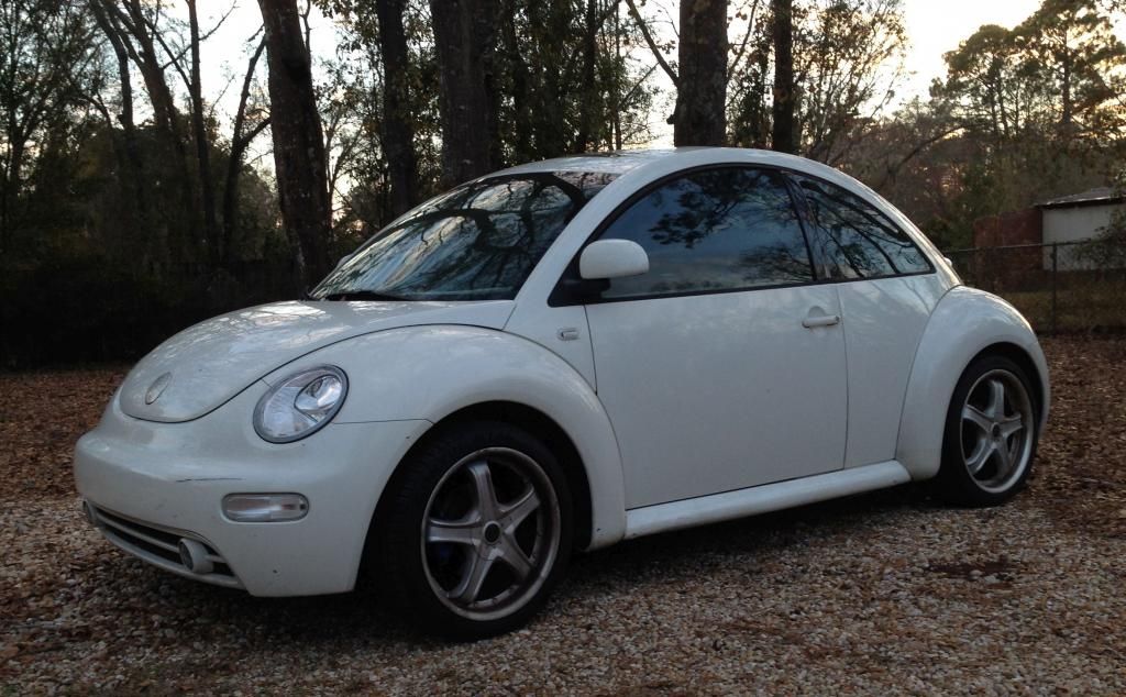

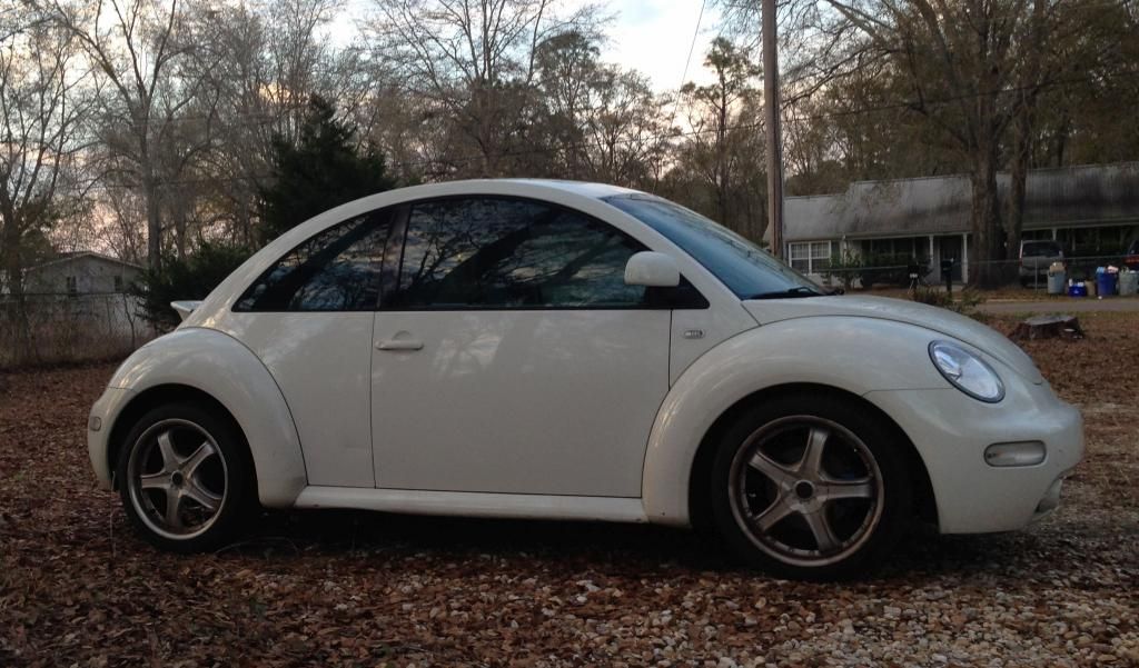

Discussion Starter · #6 ·
New Struts/Shocks/Springs/Bushings and changed to some Key West wheels. Slowly, but it's getting there.
128 Posts
Discussion Starter · #10 ·
A little more done this weekend. Replaced one torn CV joint boot, serpentine belt tensioner & idler, repaired drivers window mechanism and a couple of broken wires in the door harness, got the windows working, new door latch and a Euro light switch (no more DRLs!). Oil and all filters changed. Still have a few more things to go, but getting closer! I do like driving it with the suspension redone and the 16" wheels.:)
