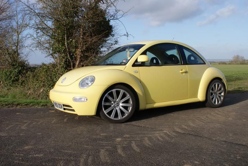

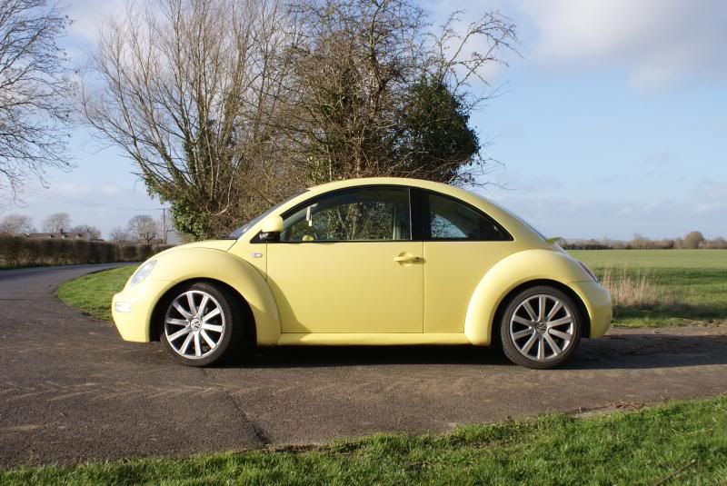

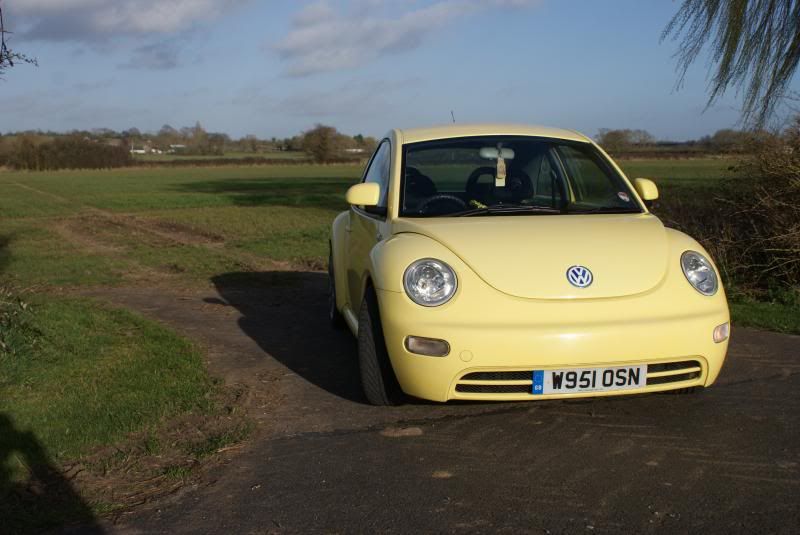

Picked up my 1st bug on Friday :D Wanted one for years, but at long last they have come down to my budget :D
Its pretty stock apart from the wheels, lowered suspension (red springs are all I can see at the mo) and a K&N induction kit. its also had the front numberplate relocated and the old screw holes (mostly :rolleyes: ) smoothed. It does have some paint issue (lacquer peel and some bad paint repairs), but I should be able to sort that with time and I am loving driving around in it even if my workmates think I'm mad :p
