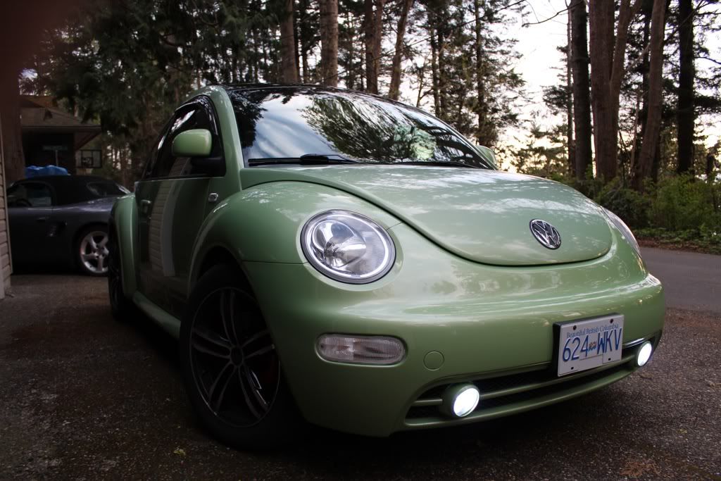

So I finally just bit the bullet and got my beetle's DRL rewired.
I also put 8000K hid kit into her! I enjoy them alot! But mounting the ballasts under there was tricky!
Cost me $65 for some asian kid to do it.
It was quite funny because he didn't know how to get the beetle into reverse!!! :D
I didn't like the dash lights being on 24/7 because I thought that was to mean to her :(
Just keeping you guys posted on my little things I do to my car
DRL no other lights on
Night time driving lights
(fogs are permanently on now)
Yay asian teenagers!
Neat chrome Euro Switch I got for FREE
