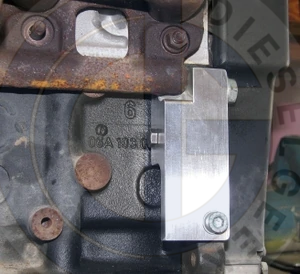

Common problem! Maybe, just use one of these block saver kits and that way, you don't have to do a engine swap?
VanGogh Broken Engine Block Saver for 2.0 Gas Engine

Ha, well the VanGogh Block saver only works with the upper ear on the block. This happened to the lower ear on the block and the bolt sheared in the block. The bolt that goes under the timing cover housing. I did purchase the block saver for the new engine to beef it up. Don't want to take this chance again.
The manifolds and piping for the BDG look identical as the BDC. I am worried more about the ECU needing a swap.

I wonder if it is possible; to make your own repair bracket; for your particular block damage, by using the dieselgeek version, as a guide?

Once again the middle motor mount bolt had sheared off into the block and would be a pain in the ass to remove and re-tap. The block is already compromised with a broken ear and so a new engine is my best bet.
