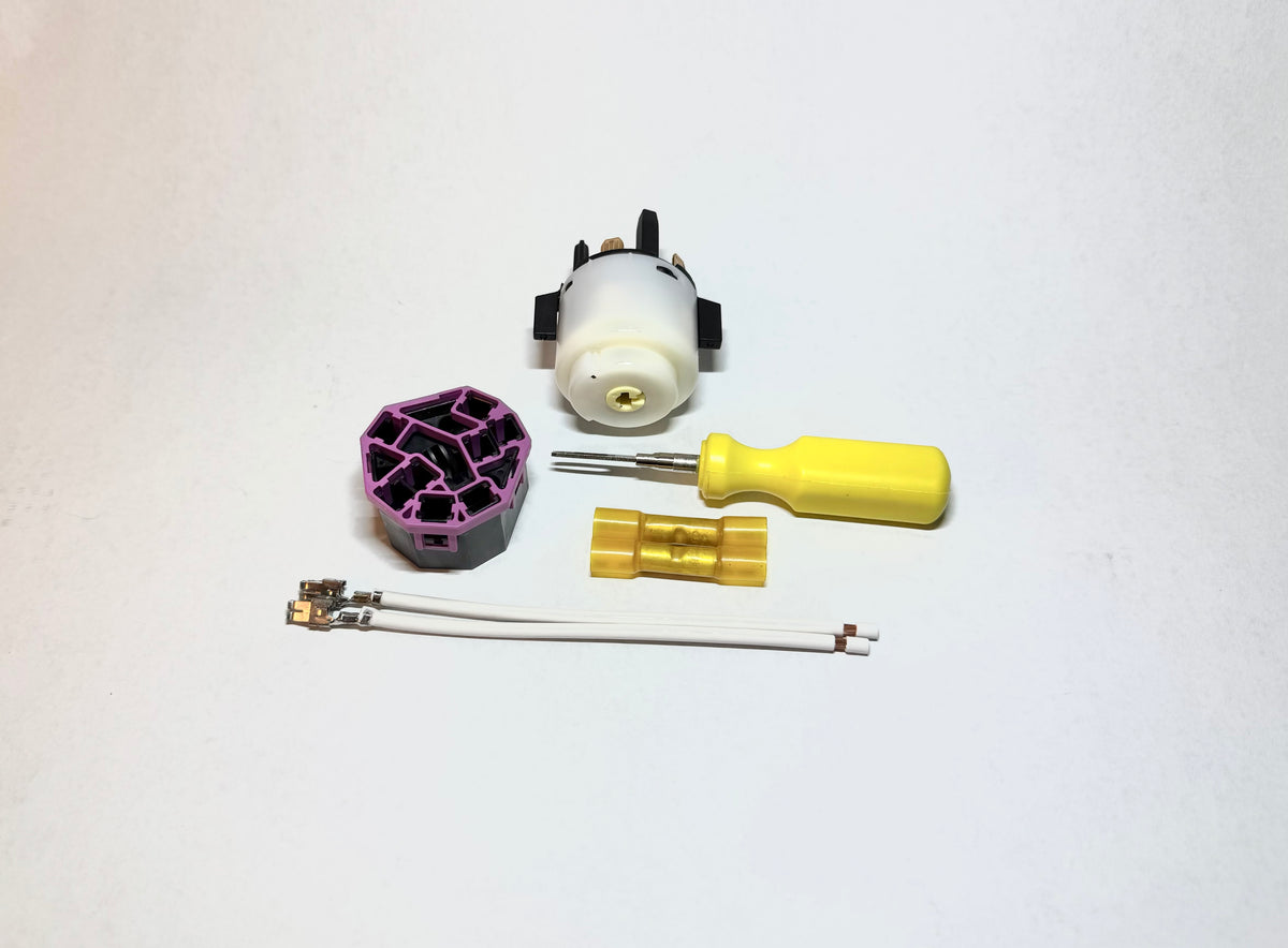

You might review this ignition switch, DIY; note possible melted wires, plug, and switch replacement.

If the starter switch is bad, that is a easy replacement and if the wires and plug to the switch are melted, you could get a replacement pigtail, to easily do that repair.
#5 ·
If you want a full kit with a switch and pigtail, with the option of getting a terminal release tool, check out this kit by Clusters by Litke:
